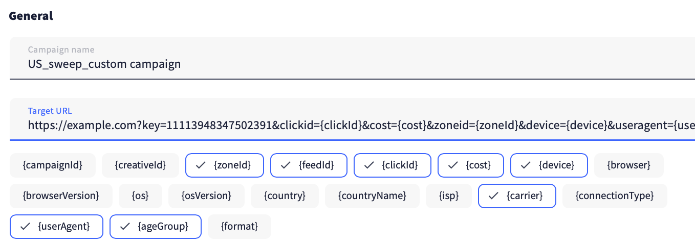

Step 2: Naming the campaign and adding the target URL.

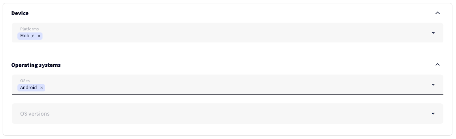

Step 7: Setting device and OS targets.

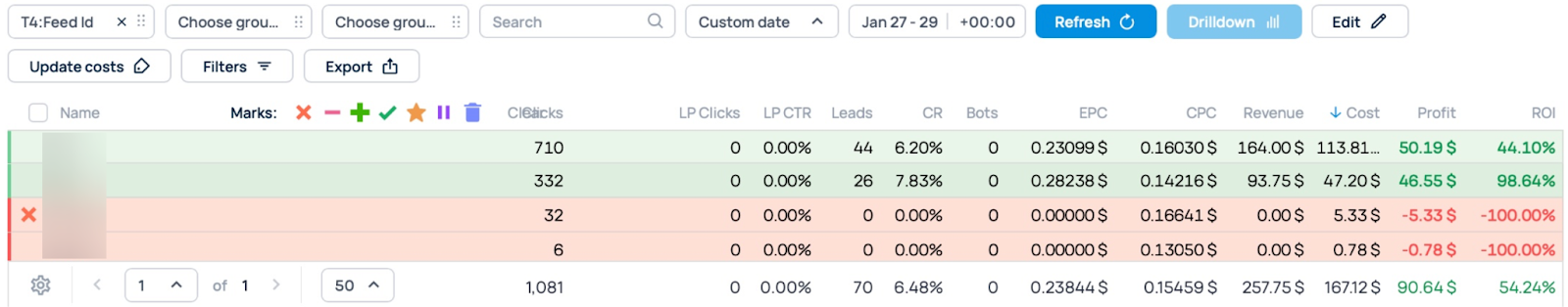

As you can see in the screenshot below, all the offers delivered great results from the very beginning.
However, even with good results, we still optimize traffic channels to improve performance. We blocked a zone with no conversions and slightly lowered the bid for a zone with -32.77% ROI to move it into the green.

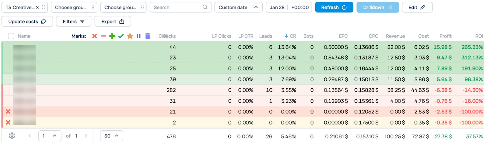

During the second day of the campaign, we increased the daily budget to $70 and optimized zone performance.
We also reviewed the performance of our creatives and removed those that failed to generate any conversions.

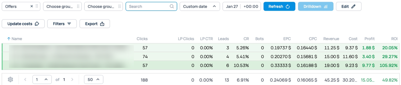

We kissed goodbye to the whitelist feed that failed to drive traffic with the current bids. Since it was the last day of our campaign, it was time to sum up the results.
Perfect match, perfect results​
This match truly worked. After just three days, we achieved amazing results.
Revenue: $257.75
Cost: $167.12
Profit: $90.64
ROI: 54.24%
